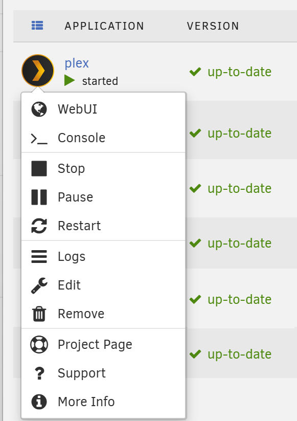

Controlling your containers
Once you've created and started your Docker container, managing it is easy through the WebGUI. This guide will walk you through using the context menu, understanding container health indicators, and accessing volume mappings within your container.
To access the container's context menu, go to the Docker or Dashboard tab and click on the container icon you want to manage. This menu offers straightforward access to common actions:
Option | Description |
WebUI | Opens the container's web interface in a new browser tab (if available). |
Console | Opens a command-line interface to interact with the container directly. |
Stop | Stops the running container. |
Pause | Pauses the container, temporarily halting all processes. |
Restart | Restarts the container, applying any configuration changes. |
Logs | Shows the container's log output for troubleshooting. |
Edit | Change container settings, such as port or volume mappings. Changes apply immediately after saving. |
Remove | Deletes the container. You can choose to remove just the container or also delete its image. |
Project Page | Opens the container's project page for documentation and support. |
Support | Provides access to support resources and help for the container. |
More Info | Displays additional information about the container and its configuration. |
